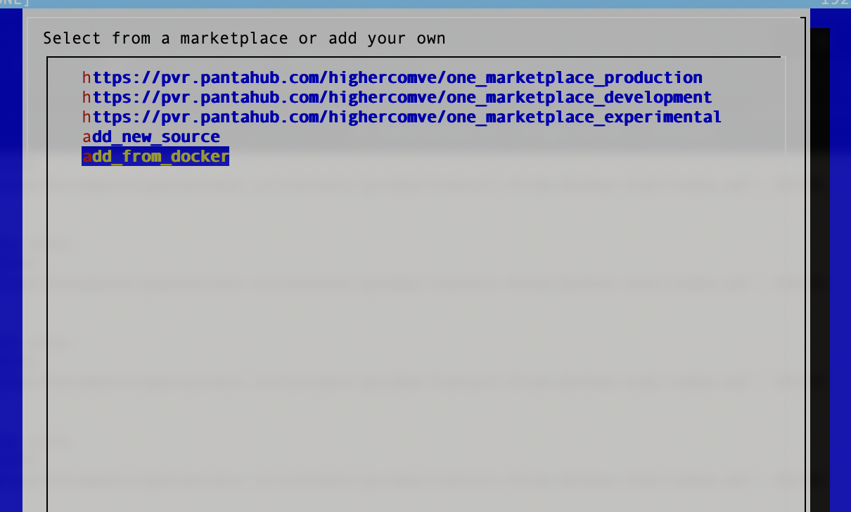

Display the menu with the pantabox
command and select Install
. Pantabox can install apps from the following three sources:
Select Docker Hub:
NGINX:latest
