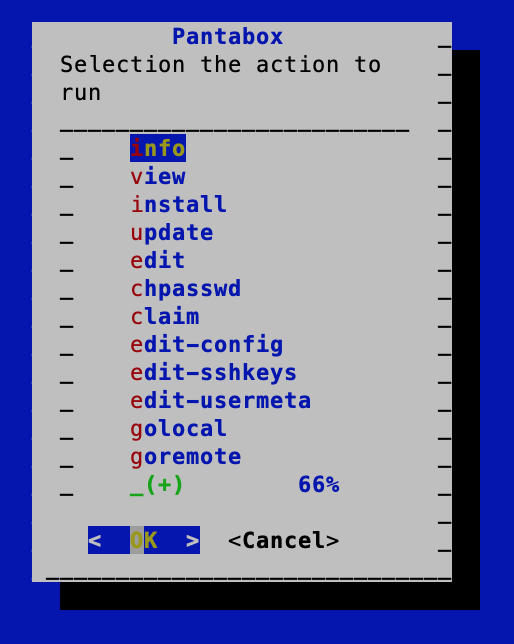

Display the pantabox menu with pantabox
and then select install

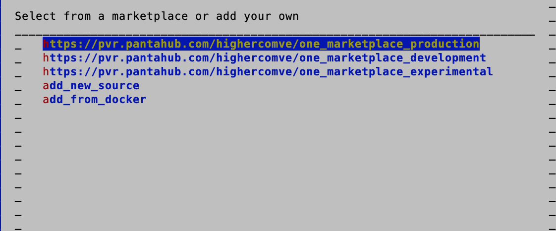

. Choose Pantacor One Marketplace:

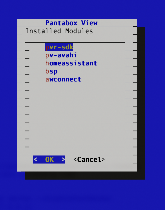

Once the app is finished installing, run pantabox
and select View

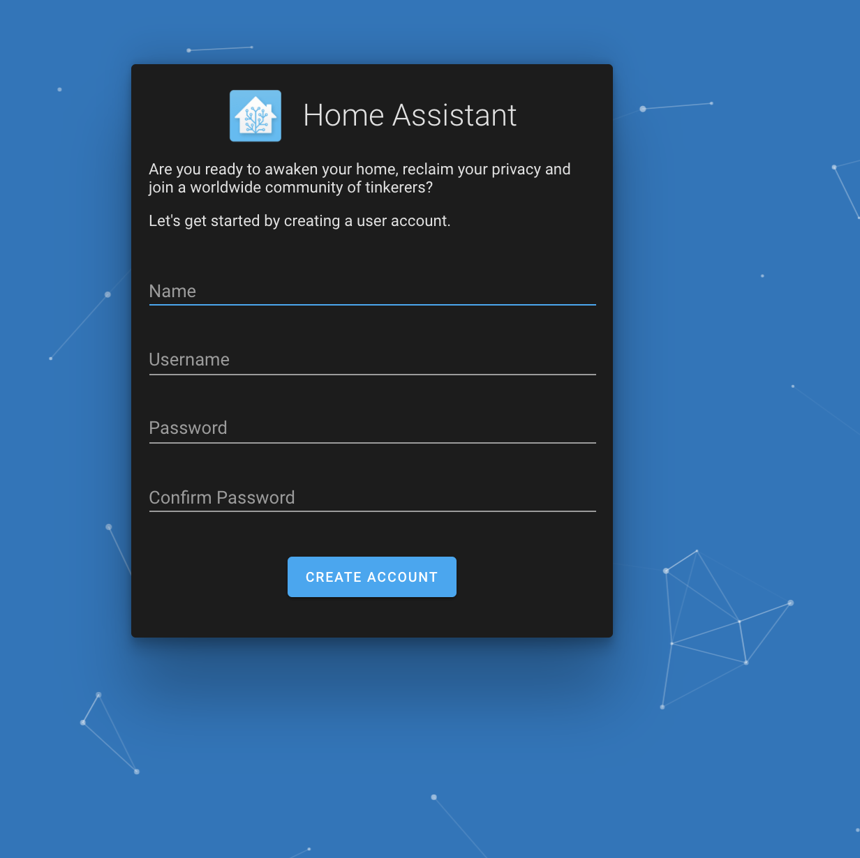

Finish setting up Home Assistant by pointing your browser at the IP address of the device (located in the right hand corner of your screen) with the port specified in the app manifest:
